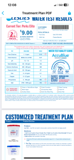

The guy at the Leslie’s store said verbatim “don’t worry about chlorine until you add your salt in a week”
Clearly he’s wrong….

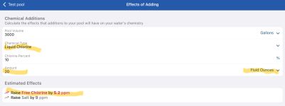

Use liquid chlorine.
Do not use any products that have Blue in the name. Blue is a code word for copper which will accumulate in your pool and stain it. Watch out for Clorox products that say Blue on them.

Your expectations for what the SWG will do for you are too high.
Use liquid chlorine to set a FC level and use the SWG to maintain th3 FC level.
