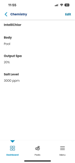

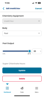

I recently moved over to Pentair Home app from IC2 app. I know noticed that the app has a maximum setting of 20% on my IC40. Luckily I use PoolController instead of Pentair’s app, so I can set whatever generation percentage I want.
Anyone else seeing this issue or have a fix in the new Home app? Just curious more than anything (as I mentioned I use PoolController).
Pentair HOME is confused and thinks it is controlling a spa which has a maximum chlorination of 20%.

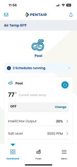

Yeah, the app home page says “pool” but under chemistry the IC is stuck as a “spa”.
Can’t figure out how to change that…
