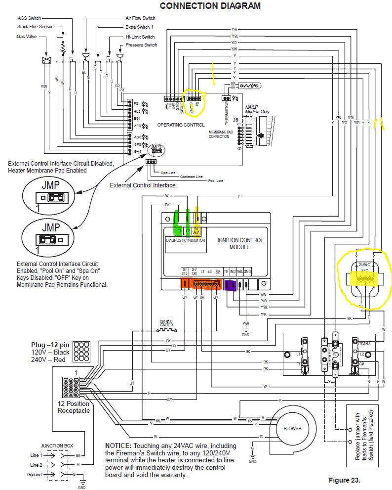

Basic troubleshooting is to follow the power using the multimeter. The wiring diagram is in the Installation Manual. The power leads from the connections at the heater through the transformer to power the PCB. That is all marked in yellow below.
You are working around high voltages so only do what is safe for you.
