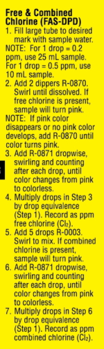

I would like to know how to interpret these test results:
  • Using a 25 ml water sample for the FAS-DPD test, it took 28 drops of R-0871 to clear the sample... so that gives me 14 ppm of bromine, correct?
  • Then I added 5 drops of R-0003 to the sample and the sample turned slightly pink. Is that combined bromine?
  • If it takes 6 drops of R-0871 to clear the sample (after adding the R-003), how do I interpret that? Is that ppm of combined bromine? If so, how much?
  • Should I SLAM the pool until I get no pink after adding the R-0003, i.e., no combined bromine?
I started SLAM at 11:00 am today. Raised bromine level to 20 ppm. At 3:00 pm it was at 14 ppm and I raised it to 20 ppm again. It is a sunny day with lots of sun coming through the windows along one side of the indoor pool. I will test again at 7:00 pm and and raise the level back to 20 ppm, if necessary. Then, I will check the level again before sunrise to see what the overnight bromine loss is. Should I continue this process until I have less than 2 ppm loss of bromine overnight in order to clear the pool of any contaminants? The pool water is very clear.
28 drops is 5.6 ppm chlorine or 12.6 ppm bromine.
It is an oxidizer that does not react with the R-0870 powder.
R-0003 is iodide and the oxidizer oxidizes the iodide to iodine, which reacts with the R-0870.
There are many different oxidizers that can cause a reading for the second part of the test.
MPS will react as will chloramines, brominated compounds, bromate, etc.
Theoretically, Combined Bromine should react in the first part of the test and not in the second part.
In practice, the "CC" part of the test for a bromine pool or spa will show results more often than most chlorine pools or spas.
Pools and spas can accumulate disinfection byproducts (DBPs).
6 drops is 2.7 ppm of bromine "equivalent" oxidizer.
