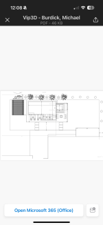

Hey Chris, thank you so much. I am so glad this post found you. You seem like someone who will help me so much!
Your property is amazing! It’s an oasis!
I did have a question in this step. I have “rough” designs that local pool companies gave us. Some gave dimensions of everything.
Ex: two different pools from two different companies.
I was curious, in this process what all am I going to be obtaining?
Would this suffice not just in the permitting process but also for electrical and plumbing subs as well?
My head is spinning trying to wrap my head around how much detail is needed in this process. Like do I need to measure everything in my backyard? Do I need to find engineers that will sketch the plumbing and electrical so when I contact the subs, they will just follow the plan?

In this process you're going from conceptual "I want a pool" through the many concepts that will work for your back yard to select a concept that you like based on your criteria. That's usually a list like:
  • What fits
  • What are my personal preferences
  • What rules do I have to comply with (local requirements for construction, set backs, HOA rules)
  • What can I afford
  • What will make wife and family happy
Once you select a concept from sketches like the ones you attached you'll need to start real design work. There's a certain amount of detail that you need to ensure the pool will work and to construct it. Most of the time some of this must be submitted to your local building department and sometimes there are additional documents. For example, you'll definitely need hydraulic calcs to size plumbing, equipment etc. And your building department will want to look at these. But they'll also want to see how you are going to comply with their requirement to implement child barriers. There are several ways to do this but they're not required to build the pool.
So at the end of the day the level of detail is driven mostly by what's needed for construction and to satisfy the permitting process in your local area. You can't build the pool using subs with the detail level in examples you show. But you can select style, location and what's affordable. To build it using subs you need at least:
  • Site drawing/survey showing location, dimensions, drainage plan(elevations) and proving you're within the setbacks.
  • Underground piping and electrical
  • Structural layout that shows where the rebar goes, how thick the concrete is, where the penetrations are for plumbing, drains, returns, lights and other fixtures
  • Hydraulic calculations, operating points
  • Electrical design details like load list, location of sub panel, bond system design, sufficient calcs to show you comply with code
  • Construction details to show things that are required to build like how you overlap rebar, position and install fittings (like skimmers, drains, light fittings, returns, spa jets etc), pipe and electrical. There are a LOT of section drawings that show constructors how to do everything from corners to light fixtures.
  • Some details are left to the constructors but not much. Mostly this is things like the brand of pipe fittings that are sometimes slightly different. Some of this I don't like for example they will often permit bell end pipe or couplers and some allow buried bond clamps that are not really designed to be buried.
  • You'll also need a complete set of specs for the grade of rebar, strength of concrete, rebar schedule, applicable codes etc.
  • Stamped structural drawings for all structural components.
  • Equipment list and pad location (usually shown on the plan view or piping layout)
Some of your required detail is a matter of how much risk you want to take. For example, my rear setback line only gives me about 1.5' of clearance from back of pool. I should be able to just measure back from the house survey but I didn't want to take a chance on this so I had the surveyor stake a like on the lot that showed exactly where the setback line was.
I hope this is helpful and please feel free to ask follow ups if needed.

Hey Chris, so I got a lot of things figured out. And am much farther along then I was. I’m getting ready to reach out to subs but I still don’t have plumbing or electrical plans and don’t really know how to do that. I have a site plan and pool plans with dimensions and everything. I don’t have all the specific plumbing plans or electrical plans. I have an idea of what I need. I don’t know how to go about getting that or creating them.
Am I gonna be able to just hand all the subs my site and pool plans and permits and they will know what to do? Or will I have to get a detailed plan for each sub? Ex: excavating plans, plumbing plans, electrical plans, gas plans. Etc.
Mike,
Where did you get the site plan and pool plans? They should include hydraulic calcs that are required for pressure drop and line sizing. Same for electrical and structural. The structural design shows rebar schedule and details plus concrete strength and thickness plus all the details needed by the craft labor to do corners, penetrations etc. You'll need to find out what your building department requires which is probably going to be stamped structural drawings, hydraulic calcs showing the actual operating point and sufficient electrical detail to demonstrate your electric service can handle the load. Even if the building department does not require stamped drawing I'd get them. Usually only costs a couple hundred $ extra to the pool design and they take personal liability for the design so it gives you a level of confidence everything will work. In my case this only required a load list for the pool sub-panel since it was installed with the house build. If you don't have an existing sub-panel they'll want you do the load list for the whole house. You'll want to get bids from the subs based on your drawings and specs from your pool design. They will expect you to give them the plans in your request for proposals from them. You'll also want to inspect their work against your plans. Building Department will require inspections that will be identified on your building permit. Once you get your plans completed you should ask to meet with a plan reviewer and get them to help you understand their process for setting up inspections etc.
