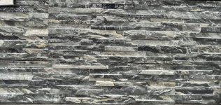

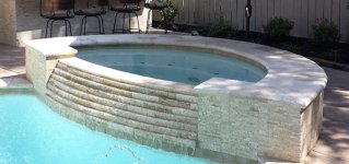

Good morning! I’m hoping to get feedback on your experience having natural stone in/around your saltwater pools. We are leaning toward a travertine pool deck, coping & spillover for our spa/pool. We’re presently under contract & in permitting, and need to make our various selections on materials. I’ve read everything from “yea go for it” to “don’t do it” all over the Internut-house, so I’d love to hear from actual folks who have it, pros/cons, and please share any pictures you may have or a link to them.
I’m up in the air on whether to have a single flat ledge across the spillover (will be 6’ wide) or a short, stacked stone step down sort of spill over. Hopefully the attached pictures (examples/inspiration) show what I’m thinking. Our spill over will only be about 12”, as we’re keeping our spa low.
We’re in SW Florida, and the spa/pool will largely be in full sun year-round, though inside a screened pool cage, if it’s of any consequence.
Thanks much, in advance, for your input/experience!
ETA: Just stumbled upon & added an example of an in-between spillover (single flat ledge spillover to step-down stacked stone). Just not sure how travertine might wear in this scenario.
A 6 ft wide spillover will take a lot of GPM to create a waterfall effect. Likely more than a pool pump can put out. You might consider lessening the opening to 2 ft. That way you can run the pump at a lesser rpm. Be sure the Spillway is created so you do not run the spillover all the time the pump is running.
Stacked stone is very pretty when new. But remember, you then have lots of surface area for the water to evaporate on and create scale on. Pretty, but not too soon after, a maintenance headache.
Reactions: The_Mother_Thing
Thank you for weighing in! I definitely don’t want to create a maintenance nightmare with the stacked stone, so if we do decide on ‘steps’, it may be better to go for a small tile with a stone look to it. And I’m almost certain the spa/spillover will have separate controls, but will double check. I do know we’re not looking for the spillover to be a major focal point though, and we don’t want it overly noisy, as there is a huge fountain in the lake behind our home that lights up at night.
Does saltwater wear on natural stone and/or grout differently than traditional chlorine pools? I love travertine, and I know it’d need to get sealed; just not sure if it loves pool water.
Any stone will erode from water flow. The salt used to make chlorine will not appreciably change that.
