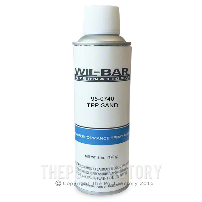

Thanks - I contacted the pool factory directly and they said the walls are considered galvanized and not to use rustoleum. They stated to use this.... just linking in case anyone needs in the future. Or they also said to use a marine grade epoxy paint

Just to set expectations, a 2K epoxy coating would be best (after removing ALL rust). Anything you apply from a spray can is going to not be as good as the factory coating. Given the factory coating has already failed, you should keep an eye on that spot.

Just my opinion but it doesn't look like that paint will address the rust at all so you will need to remove any visible rust. How to get rid of it is either elbow grease with wire brush or very fine sandpaper or that rust dissolver Rust-Oleum 8 oz. Rust Dissolver Jelly 322435 - The Home Depot
Remember rust is oxidation of metal and you need to get rid of it all to stop it before covering it. Once the rust is gone then use that paint. But make sure you keep an eye on it through the year and years.

Thanks Vinny. I'm not going to use that product from the manufacturer. In talking with rustoleum and a friend that restores cars I've settled on this. After scraping away the loose paint using below. Does this sound good?
Rustoleum universal bonding https://www.lowes.com/pd/Rust-Oleum...Vqg6zAB1zgwLSEAQYAyABEgIIM_D_BwE&gclsrc=aw.ds
Then using this on the parts of the wall that now have exposed metal https://www.lowes.com/pd/Rust-Oleum...Vqg6zAB1zgwLSEAQYAyABEgIIM_D_BwE&gclsrc=aw.ds
Those are both primers. You want a top coat to go over a primer as primers allow moisture to seep through.
