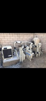

Hydraulics is a very important part of the pool and spa, this is an example of what you will be taking on.
Thanks for the pics. That last picture of your spa is a bit intimidating, but I'm ok with a challenging and complicated project. Honestly, the appeal of a finished, working pool has turned out to be only part of the lure at this point. The learning and doing side of this project still has some shine to it. Perhaps that will fade quickly! The thing I'm realizing is the most against me is time, since we've already had the excavation sitting for over a month and had some fairly significant cave-ins along the sides from the freeze/thaw over the holidays. If I had the luxury of endless time, I'm confident I could do this and get it right. However, with the goal of getting to a stable point in the project, I'm looking into what it would cost to have enough of the plumbing done to allow us to proceed to gunite.

I will keep the heater bypass. I'm still curious if others (particularly those in warm states) see the advantage of having this be automated.
While that is feasible you need to ask how often you need to rotate it. Having the heater bypassed would be for draining the or servicing the heater. In the winter you may wish to have it completely bypassed unless you use your spa a lot during the winter. Just ensure whichever automation system, that you have sufficient relays to control multiple valves.
I will keep the filter bypass. I've seen people recommend connecting the bypass line to a hose bib, so unless I hear otherwise that's my plan.
The hose bib on the end of the pipe is convenient to attach a hose and push water away from the pad or other sensitive areas. As a reminder, if you plan to drain your pool completely then it is best to use a sump pump. If you have to drain 4 inches due to heavy rains then the use of the main pump is convenient. Having a drain bypass is also very helpful if you have to vacuum and you want to go to waste. Some people with heavy algae elect to use a manual vacuum connected to skimmer line and push the algae to waste rather than through the filter. So there are many different scenarios to have a bypass prior to the filter.
Draining brings up another subject. Have you considered putting in an overflow line. This would be put right above tile level, so any heavy rains will drain to a designated line. you would need to also lay a full drain line to some point as well.
Heater bypass…
Unless you need a manual bypass due to high water flow you should use the automatic bypass feature standard on the latest MasterTemp model you will be getting. This does not require the valve to be connected to your automation system.
See pages 14-15 of the MasterTemp Installation Manual…

Can you share why you're committed to only one skimmer?
Have you considered a single three-way diverter downstream of your skimmer and main drain lines instead of 2 two-way valves?

  • Regarding the single 3-way diverter:
    • I hadn't considered that option, so I should. Do you have an example photo or schematic of what that looks like?
    • I need to add a line for a suction cleaner (assuming I need a separate line for that), because my schematic doesn't show it.
    • That would be plumbed in with the rest of the suction from the pool, right? So would the single 3-way diverter still work? What I'm trying to achieve is a way to adjust how much flows from the skimmer vs the main drain.
    • If you have an example of how that might work plus the separate suction line, that would be great. Or maybe educate me on suction cleaners? Maybe they don't require their own line?
Between a suction cleaner, a pressure cleaner, or a robot cleaner the suction cleaner is the worst type of cleaner to choose. It is antiquated technology and just clogs your filter more rapidly with debris.
There are pros and cons to pressure cleaners versus robots but both are superior to a suction cleaner.
