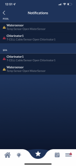

If it is a new pool then call your Pool Builder and make a warranty claim.
Open up your Omni panel and find the connection for the water temperature sensor. Check the wire connection and if it looks good check the thermistor using a multimeter.
For the chlorinator message look at the plug on your TCell cable into the Omni board for burn marks. You should not have this problem with a new unit.
