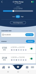

I'm certainly no expert like others but I do have an omnihub system so I'll throw in my 2 cents. I believe what I have is probably mostly the same as what you have as far as settings are concerned. One thing to make sure of on the schedules, is set your new schedule to start say 2 minutes before your old schedule ends. For example, with your current schedule of 8-2 at 100% and then 2-8 at 50%, I'd set it as follows:
7:58 am to 2 pm at 100%
1:58 pm to 8:00 am at 50%
I'll attach a screenshot of my pump run times just to give you an idea. Why? In my experience, If you start and stop right at 2 pm, it sometimes can be buggy and shut off at 2 pm and not run the next schedule. They may have adjusted this in updates but if you've noticed it shutting off....that's probably why. It happened to me in the past.
