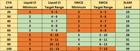

Your FC is low for CYA 70 with a SWG. I would crank up your SWG to get to around 9.

Thanks for the information, I don’t fully understand the chart because I’m still new at this. My SWG is set to 40% now, I’m going up to sixty for the week and test again. Thanks again
