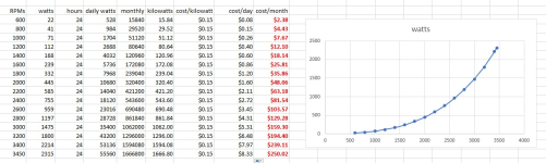

Run the pump as slow as possible while still achieving your requirements (SWCG and skimmers working, etc.). I operate 24/7 at slow speed (1000 RPM). This consumes ~70 Watts and costs $5/month in electricity. I like the constant skimming, chlorination, filtration, and circulation.

Yes, if your pool is setup appropriately. I can operate continuously year-round for $5/month.
