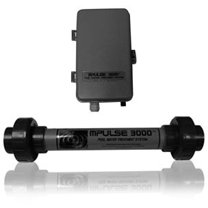

Natural stone is porous and you are going to be dealing with this situation from now on, only question is at what level. You may want to look into this product as a maintenance way to keep this under control.
ScaleTec looks like something you add to the pool - correct ? Not to directly apply to calcium?
That is correct. I don't see much benefit to using such products. With proper testing and water management, you can maintain a proper "CSI" level (slightly negative) to prevent scale in a pool. But that's different from the water spray and evaporation from a spillover. Speaking of testing, be very cautious about the pool store tests. They are most often wrong. That is confirmed by some of those numbers posted above that have fluctuated significantly. Ask Santa to get you a TF-100 or Taylor K-2006C test kit, and get a magnetic speedstir as well. You'll be glad you did.
