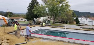

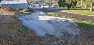

We built a temporary road below the pool. I live on a corner lot and we used that road for all deliveries from pool equipment, stone chips, pool delivery, equipment delivery and concrete delivery. The borough was not happy about having all this done because they just paved the road BUT... they approved my permits so we had to get creative and told them, we will not drive on the road at all. My neighbor allowed us access to drive in front of his business for all deliveries.
