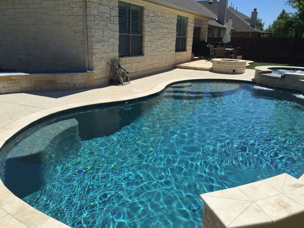

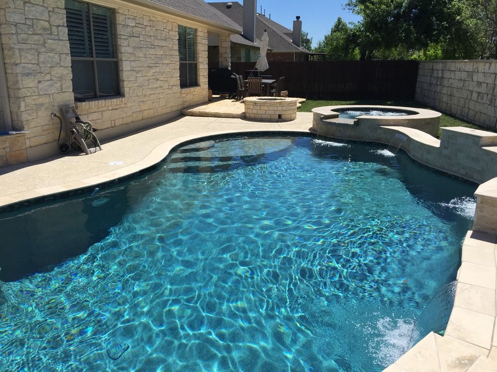

Your plaster is SO pretty! Could you please put your plaster color in your siggy as I know there are going to be people looking at it and wanting to know so they can copy it! (yeah I know they can read your whole thread but.....)
