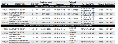

Hi gang! I just received the Pentair Intellflo3 VSF 011077 that I ordered (Jandy pump is finally giving up the ghost). I just unboxed it and was looking it over, and I'm completely stumped by the label on the motor housing.
The label on the motor says 1.5THP and the rest of the label matches Pentair's electrical specs for the 1.5HP variant of these pumps. This is odd because the 011077 model is supposed to be a 3.0HP pump. The label on the box as well as on the side of the pump housing both confirm this is a 011077 pump, and the overall measurements match Pentair's diagrams for the 3.0HP variants.

The 1.5 HP motor will overheat and fail prematurely if run at high speed with the 3 HP impeller.
It should not be assumed the wet end is the correct 3HP.
The wet end also has a different size with 11.3" vs. 10.6 in.

In terms of measurements, the overall length of the assembly is exactly 26" (as it should be for the 3HP version) though it's worth noting that the overall length measurement is based on the electronics compartment on top - not the motor itself.
