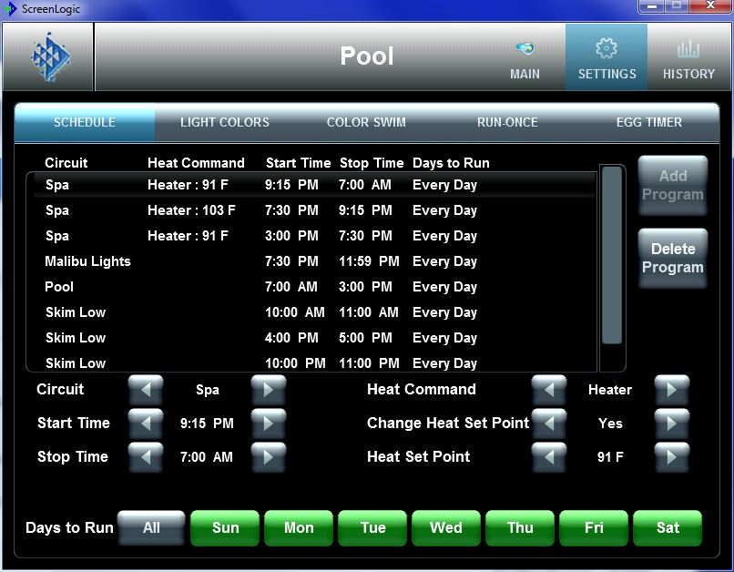

This under SL Config. Easier is on the windows based program.
If you select Yes, heater is on all the time pump is. I use Don’t Change and manual, so if I want heater, I have to touch Heat on the ScreenLogic Connect app.
As said, much easier to set this up use the windows based program. Download it from Pentair website.
