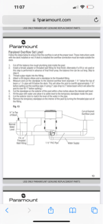

start up guy had already come to start everything and removed one of the hoses, but it still was’t progressing, so I put the wand hose back in. A few hours later I went out to check on it and heard water flowing into my dry well which is connected to my deck drain and AutoFill/overflow. I opened up the autofill cover and realized they never connected the autofill and thought that was the problem, but after installing it, the flow wasn’t stopping. I ran to Lowes to buy a cap(of course I didn’t have any around that size), and just cut the line before the dry well and capped it, which allowed the pool to fill up the rest of the way within about an hour and half. I was cursing the pool builder the whole time, until later in bed that night I looked up the auto fill/drain Plumbing Instructions on their website, and realized that the float only dealt with the flow portion, not drain. At that point, I realized that it is basically an only a pipe and needs to turn back up and not be pitched like a drain! I can only blame myself because I am the one that took the pipe nobody terminated and put it into the dry well.. opps! I estimate I used an extra 1,800 gallons of water!
