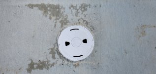

And now the bad. Pool builder hired a concrete company he admitted to never working with before and chose not to show up the day it was poured. After the pour I was told that the concrete crew boss decided to go on vacation and was not on site for the pour and the guy that seemed to be running the show said he's never done a cantilevered coping form like that. They did not vibe anything as they weren't told to bring that equipment or do that. I also did not observe them put down any form oil. This is the result. The brushing is horrible, there are holes in spots around the skimmer lid, the actual flat work is wavy and ponds water. The coping, well, a disaster. This was poured last Friday.

I could try calling the pool company office but they have expanded operations to include a large manufacturing facility where they make rails, over the edge pool features, slides, etc. It's a pretty big operation and I was told by the pool builder that the owner would not call me. I'm guessing this really just doesn't matter to them. The PB did text this morning to state that the concrete company owner would be over here this Saturday to inspect. I've attached a bunch of pictures and will attach a few more, but hit my max for this post. The first gives you a general picture of the layout, the rest show just some of the trouble areas. Note the poor placement of a joint next to a skimmer lid - it has already cracked and chipped away. Brushing changes directions randomly and not at joints and in some places does not get all the way to pool edge. The edge of the auto cover tub is protruding at least 3/8" above the concrete in one corner.
