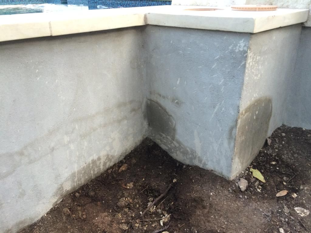

Here's a better picture of the issue.
Definitely a sizable leak and not a good sign; on a good note (because of the size) it was noticed early and will get addressed quickly!

PB plugged the obvious leaky skimmer, shut both skimmers off and we still lost another inch last night. The area and soil behind that skimmer is still wet.
He said the crew might have to put a hole in the skimmer concrete encasing and dig up the pipes to equipment pad.
And the fact that we lost more water with the skimmers turned off suggests we might have issue in another area.

No luck plugging the skimmer - we still lost almost 2 inches overnight. PB (well, his plumber) should be out tomorrow to pressure test and hopefully fix. PB said they can pressure test everything except the main drain. Hoping to have it resolved this week.

I'm not an expert...but I have owned a few houses with natural stone finishes and with Acme brick facades. If your materials are natural stone and if they have not been sealed, then they can absorb some water and even transfer water to the stone next door. I'm not saying that this is what is happening, I'm just saying that this looks exactly like my last house when the rains would over flow my gutters occasionally.
