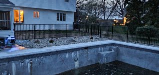

Plaster will be sometime around mid-April. In the meantime my pool looks like this full of half-frozen dirty water. I have alot of the white goop oozing out of my gunite that others have posted about which doesn't concern me based on what I've read in those threads.

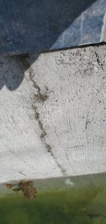

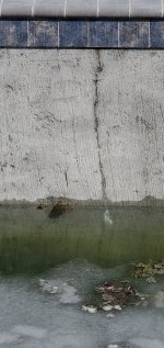

However, I am a little uneasy about this vertical line running down the wall. I can't see any crack, but I'm wondering if it might be indicative of a crack deeper in the bond beam? Does this look normal, or should I be concerned?

Cracks are what concrete does. The rebar holds the structure together. The plaster waterproofs it.

Thanks for the peace of mind. I wasn't sure if structurally this would cause problems later post plaster, but it doesn't sound like something to worry about.

Alot of that is ground water that came up through the hydrostatic relief valves since the fall. We have a relatively high water table here. The builder is here now as I type adding additional pumps to try to get the water out of the shell in preparation for plaster.
