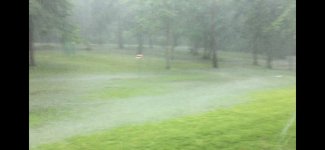

I wanted to add an entry about drainage and the location of the pool. The backyard slopes a lot from left to right. The elevation difference between the planned left edge of the deck and the right edge is close to 3'. The yard also slopes back to the front. A nearly 20' wide and up to 18" deep swale runs left to right much of the backyard. The house is elevated above the swale. Around 60' from the house, the elevation returns to the same height as the back porch. The yard continues a steeper slope as you move further back. We would have a serious drainage challenge if we put the pool where the back porch and deck area join.
Rain tends to come in bunches here in the Houston area. We have had at least six times in the seven years we have lived here that rain has turned the swale into a rushing river. Below is a blurry picture of one time early in the flood stage. The level of water in that picture has happened dozens of times. The picture may also give you an idea of the slope in the backyard.
We plan to have the walkway from the porch out to the pool go through the swale and allow the water to flow over it naturally. You may be able to tell from the earlier pictures that I posted that the back portion of the deck, where the spa and firepit area is elevated 12" above the front deck. There will be a drainage design that shunts the water from the left and back around the pool area to flow down to the drainage ditch that is on the right side of the property. Much of this will be accomplished with proper grading. A retaining wall and/or culverts may be necessary, but that design is pending.
