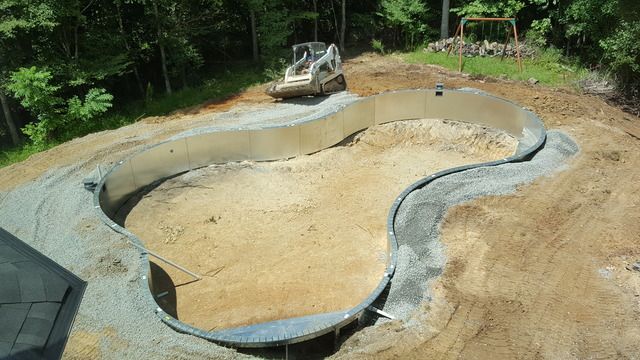

Almost done with the backfill which was 4 trucks of #57 gravel against the shell and the dig soil graded to flatten the area around the pool
