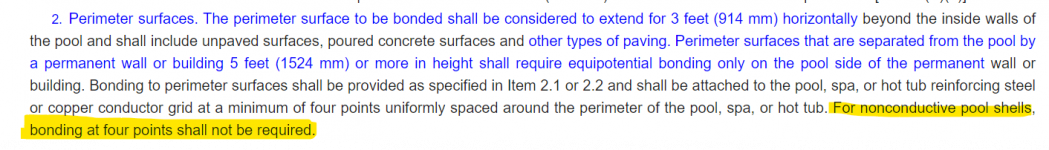

I am not sure 4 point bonding is required for fiberglass pools. Based on IRC E4202.2: "For nonconductive pool shells, bonding at four points shall not be required".

1678932266544-png.477391
That refers to bonding to the actual pool structure.
For a concrete pool with rebar, it requires 4 bond points to the rebar in the gunite or shotcrete.
For a vinyl pool with steel walls, it requires 4 bond points to the steel walls.
If the coping is conductive (Like metal (aluminum etc.)), then that requires 4 bonded points or bonding to each individual piece of metal coping.
If the fiberglass is considered to be nonconductive, then you do not need to bond to the fiberglass shell.
However, the perimeter bonding requirements are still in effect.
Some places allow a single loop of copper bond wire (#8 solid bare copper) instead of a 3 foot metal grid.
