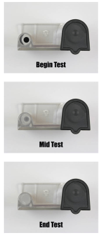

Mix the CYA mixture, fill to the first line. Stand outdoors, sun to your back, hold the test tube with your finger and thumb at the top, hold it at your waist in the shadow of your body. GLANCE at the tube. If the dot is obscured (see pic), you are done. Take the number on that line and add 10. If not, fill to the next line and repeat. When the dot is obscured at any particular line, take that number and add 10. This applies to the regular or diluted test. Take the diluted test number on the line, add 10, then multiply by 2.

You can do either. It is not typical that CYA changes over the course of the SLAM. It is important, however, to have an accurate CYA test result to slam successfully. Understood, I will have him review the CYA testing process that you provided, and have him perform the CYA test. At this time, its raining pretty good at our location, so once that concludes, I will have him perform the test
Mix the CYA mixture, fill to the first line. Stand outdoors, sun to your back, hold the test tube with your finger and thumb at the top, hold it at your waist in the shadow of your body. GLANCE at the tube. If the dot is obscured (see pic), you are done. Take the number on that line and add 10. If not, fill to the next line and repeat. When the dot is obscured at any particular line, take that number and add 10. This applies to the regular or diluted test. Take the diluted test number on the line, add 10, then multiply by 2. I will post the CYA results once we have that opportunity
