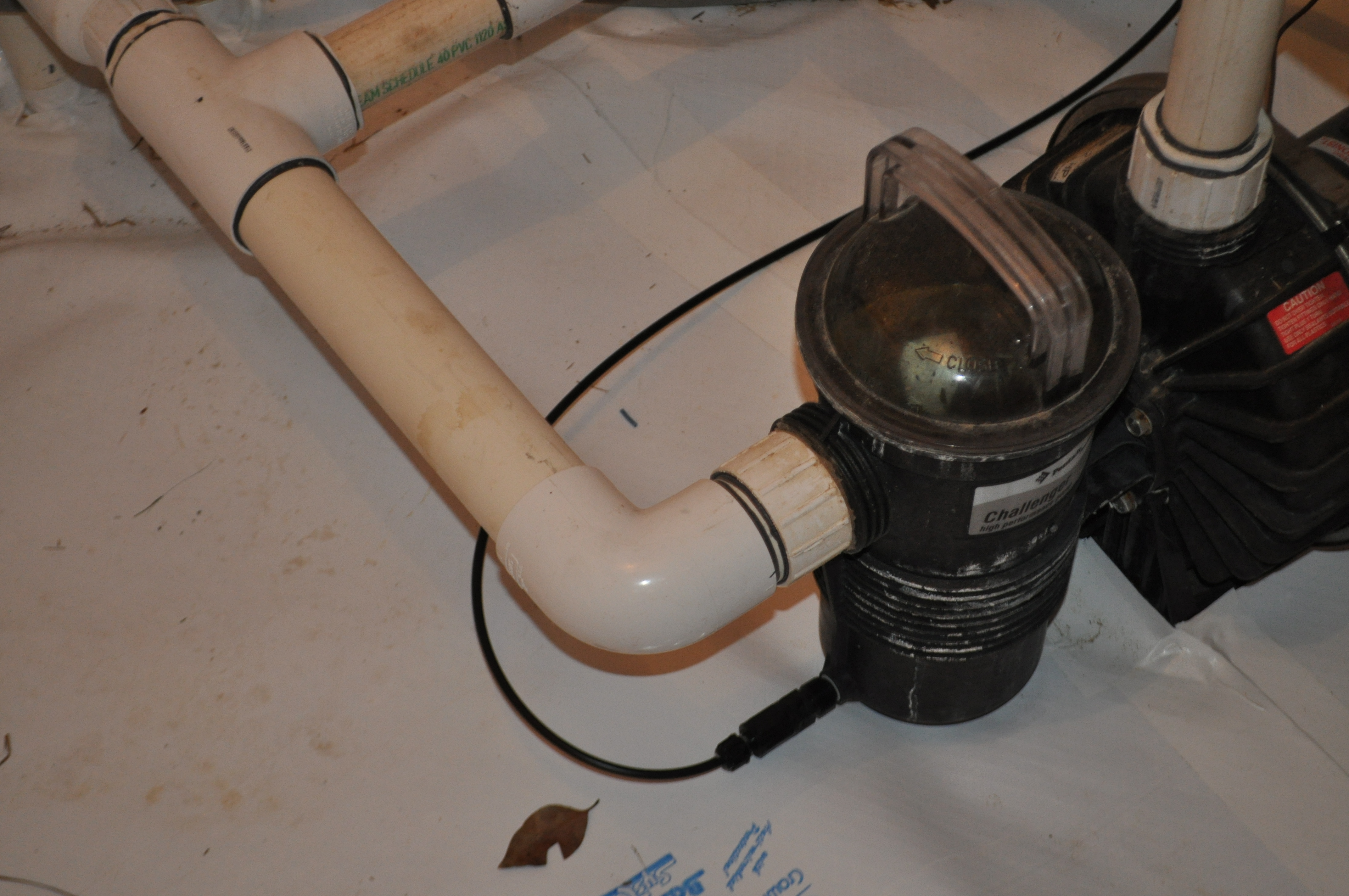

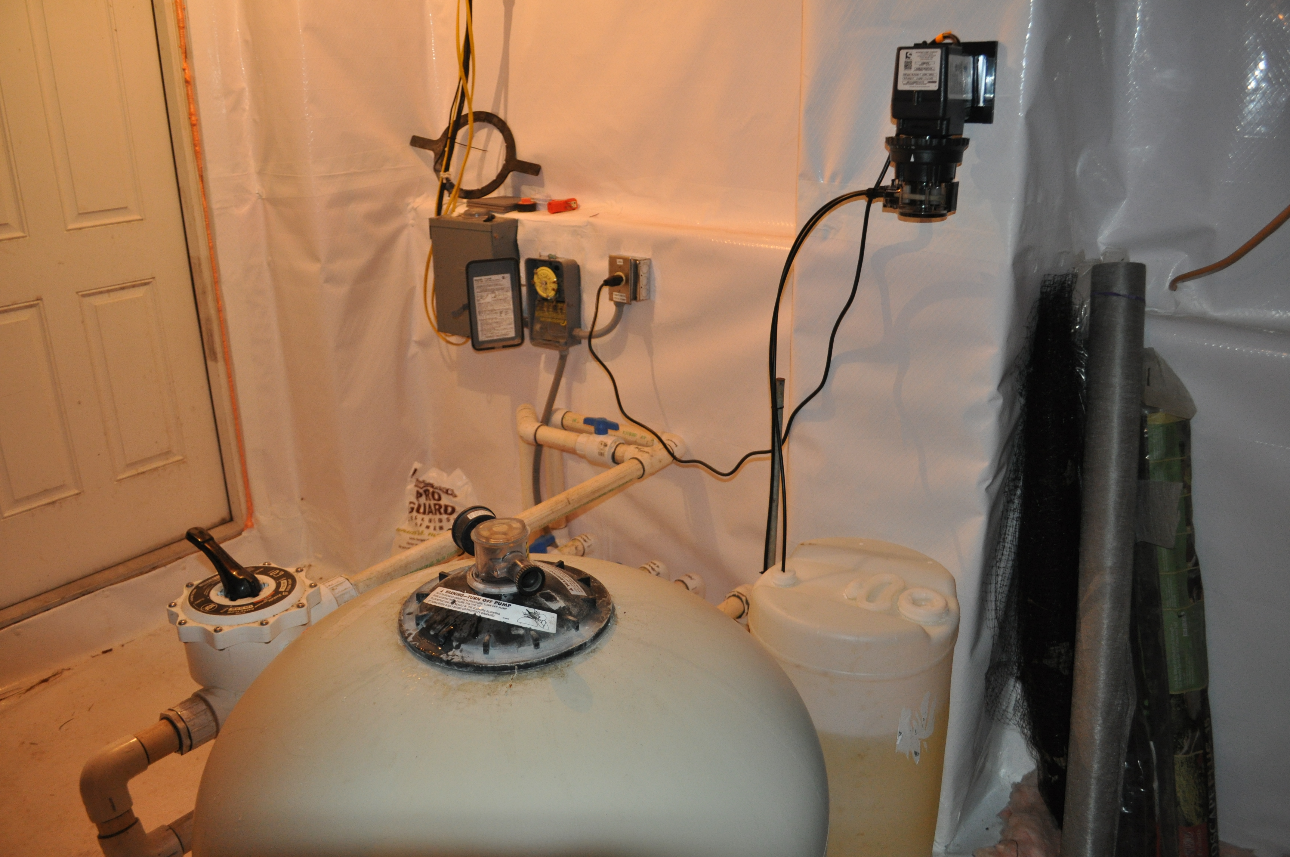

I purchased the 45MHP2 Single Head Adjustable Output High Pressure Pump in 220v from USwatersystems. The day I ordered it I went by Lowes and picked up my electrical needs, including a NEMA 6/20 receptacle.
I wired this receptacle up to the timer that powered the 220v pool pump, so when the pump is on the receptacle is hot.
I received the pump as well as a tank from another TFPC member who found them for a reasonable price, but had to buy three. He was nice enough to pass the savings along to two other folks! It took about 30 minutes to mount the pump to the wall and plumb it into the system. It plugs right into the receptacle, so no cutting off the plug supplied.
Right now I have it injecting into the pump strainer basket, but plan on moving the injection point into the 2" return pipe when I get some "extra" time.
Now, understand I installed all this the afternoon the wife & I had to leave town for 10 days. My choice was start the Stenner or float pucks. The Stenner won.

I raised the FC in the pool to 10, filled the tank, turned it on and left town. To be honest, I didn't trust my math skills, so I actually set it at 65% before we left.
Ten days later I returned home. I was imagining broken hoses with chlorine under my house, an empty chlorine tank and a green pool - all kinds of things. Well, I came home to a beautiful pool with my FC sitting at 7.0. As I need to keep my FC between 6 - 9 due to my CYA level I will need to play with my settings just a little.

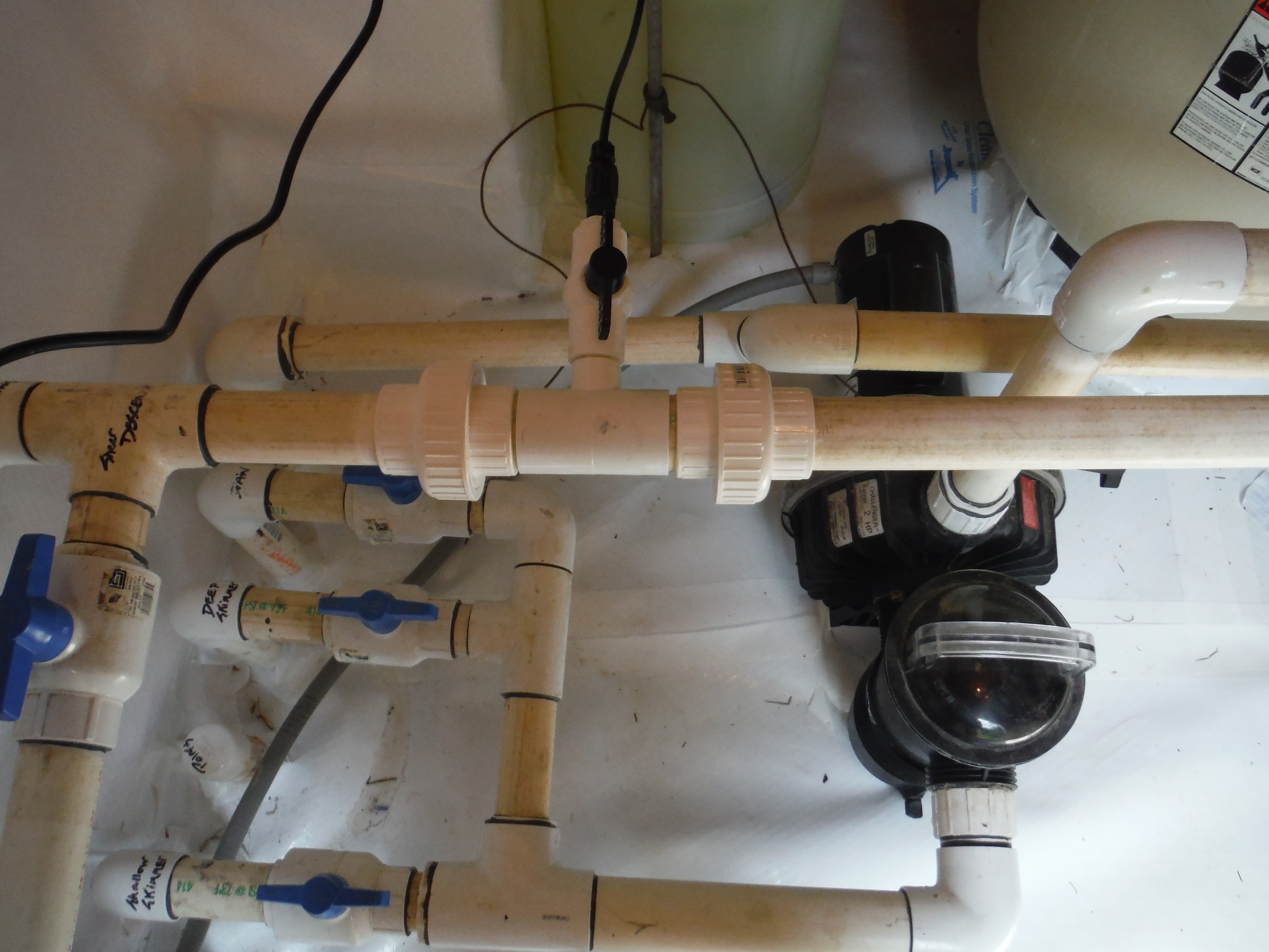

I finally got time in my schedule and changed the injection point from the pump strainer basket to it's own spot in the return line to the pool. Due to my plumbing, I had to cut the return pipe and use unions to set it back in place rather then just adding a "T". I also added a shut off valve so I can remove the Stenner one way valve if need be without shutting down the system.
