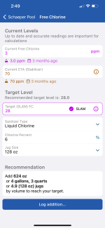

But anyway, if it is algae and I have to SLAM a little confused by this statement... "Test the FC level and add enough chlorine to bring FC up to SLAM level 3-4 times per day." I used the calculator and it says I need almost 5 gallons to get to SLAM level (28 FC). I'm guessing the algae eats the chlorine so thats why you have to keep adding it...but how much chlorine will I know I need to complete this process? I don't want to buy too much as we have a SWG and don't really need it. And on the first day do I just dump all 5 gallons in at once?
Test FC, then add enough to get to SLAM level. Wait 2-3 hours, test FC again, add enough to get from that FC to slam level. Each time the amount will be different.
SLAM is shock, level and maintain. You are trying to maintain, so only add what you need from the FC test back to SLAM level.
