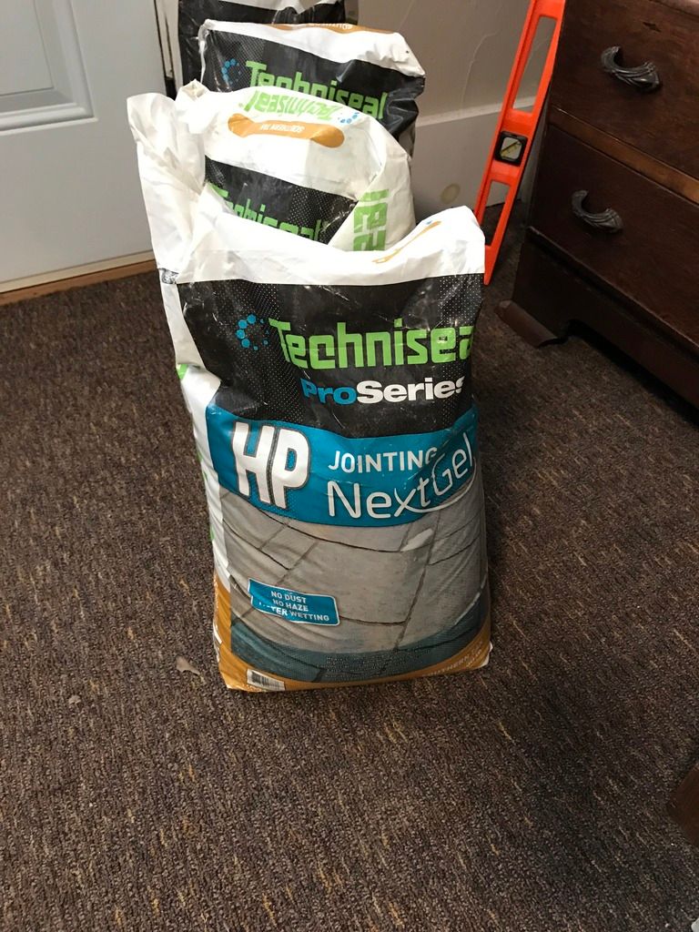

2) What kind of sand are they using to fill the gaps. Is it the kind that hardens? Did it look look like this stuff...?
PolyMetric Sand
I think they charged $12 per square foot. Cement was $7 and Travertine was $15-17.....I'm really not 100% on that.

Poly Metric sand was laid down and then watered in. They also replaced and cut the new pavers that needed attention. Didn't have to point anything out they just knew what to do.

I love they took care of the "bad" ones without you having to point anything out. The sand really does make a difference to give it a finished look.
