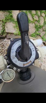

My Hayward multiport is making a crackling noise and filling the notches on top with water. I replaced the spider gasket but made no difference. Any ideas? I have a short video but no clue how to post it.

To build on what @Texas Splash said. Replace parts 3, 8 & 9. That should fix whatever leak you have on the valve stem.
