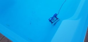

Day 10. Can't remember the last time I had ice on the robot when I put it in the pool!
FC 16
CC 1
As of 1130pm last night, having added chemicals around 9pm, lost only .5 FC. CC remains at 1 as it has for the last couple days.
Pool is very clear.

Good news, you’re done!
Change the sand and once that’s done add the CYA. Keep things at an FC of 15 until that last bit of CC’s disappear, but with this awesome weather we’re having you should expect little chlorine loss once you get some CYA
Congrats!! No more baqua
