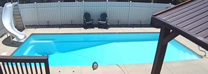

May the fun begin - conversion of 15 yr Baquacil pool

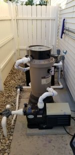

Pump to the new Hayward 65 DE plumbed but 930pm brought 45 degree temp. It will be finished and back up and running by sunset tomorrow 5/12.

Only one little leak.... but I am pleased with the outcome. 12 psi after 6 lbs DE. Jets and slide all seem good pressure.
If the weather stays this way, it will be swimable in 3 weeks. Yeah, we have frost advisories again tonight in NW Ohio.

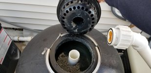

New DE is in. Need to let the glue set for a couple hours. Pump has been off for 24 hrs. Pool still crystal clear.
I hate to be the one to spoil such a beautiful glue job (and I hope I’m wrong), but it looks like a couple of the fittings on the pump to filter connection are shallow like DWV instead of Schedule 40 PVC?
