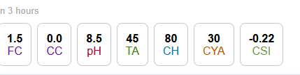

Hi everyone, please take a look at my poolmath logs. My levels are all messed up and I have no idea what to start correcting first. Also I'm in the process of adding notes for the testing results please take a look at them because sometimes the results well they were just some things that were sort of weird about them that I thought might be helpful to you.
The notes are added now so let me know your thoughts if you have time
Thanks!
You need more chlorine. Add at least 4ppm of liquid chlorine to the water. 1/2 gallon of 10% liquid chlorine will give you 4.2 ppm.
Your pH is high. Post pictures of your pH test with 4 drops and 5 drops.
Show us this...
img_0960-jpeg.640753
TA is fine at 50.
CH is fine for fiberglass pools unless you have a gas heater or the pool manufacturer specifies otherwise. With a gas heater you should have at least 200 ppm of calcium.

Until today, it looks like your last CH test from 7 months ago was 100. You reported CH of 80 today.
Your signature shows you have a gas heater. You need to increase your CH to at least 200.
TA of '45' gets rounded up to 50.
Your FC is way too low.
I'd suggest an Overnight Chlorine Loss Test - if you pass, increase your CYA in anticipation of increased temperatures and dose FC according to the FC/CYA Levels chart for a non-SWG pool.
