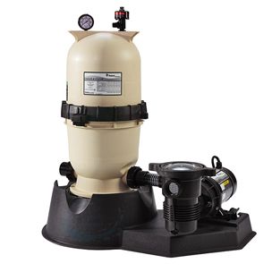

As you can see from my signature about 5 years ago I bought a pentair clean & clear 75sq and 1 HP combo unit pump/filter. I mainly bought it because I'm not handy and didn't want to have to connect a whole bunch of different hoses. Since it's a 1HP motor I only run my pump about 3 hours a day to save on costs (5,000 gal pool so it's ok, water is usually clear).
I want to buy a 2 speed pump but I don't really see one on pentair's site for an above ground and I'm not sure what would be compatible with the filter if I bought a different brand. Just looking for some guidance or advice. Thank you

EDIT: Found one here, but I would have no idea how to make it 'compatible' with my pentair cartridge filter. See below with what I currently have. Thanks

There is a good discussion on this thread on why having a too large pump is not good for filters.
I think that 1.5 HP pump will not work well with your little cartridge filter.
But I would only use the 1.5 just for vacuuming. For daily running I'd use the low speed. Is that ok
If your current pump is 1 HP as you say and low speed is .39 HP then your filter should be able to handle it.
