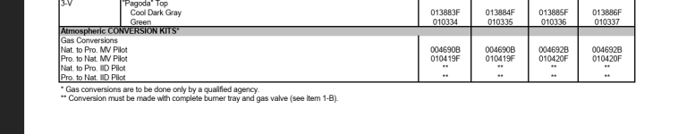

Oh wow, I didn't know I'd need to get the whole burner tray. Dang, that might be expensive. Oh well, I guess it's still cheaper than a whole new heater. Thanks very much for the information, I'll start trying to price and find one!
You can do the job with all new propane burner orifices ($6 - $20 each, need 27), a new propane main valve (Honeywell aftermarket with propane conversion +/-$150.00), a new pilot burner with the propane orifice installed (its in the kit $30 - $40, 002003F), and breaking off a tab on the circuit board to tell the control you are using propane so that it locks out after a failed ignition as a safety measure (this is very important, the tab is at the edge and marked). A lot of work and expense. The burners themselves don't change. If you don't change all of those items the heater will literally burn itself up. The tray for propane, complete, is about $1300.00.

The burners are the same for Natural and Propane and for different sizes except for the number.
The orifices are different for Natural vs. Propane and by elevation and number.
Burner Orifice #57* (0-1999 ft elevation) 350083F/27.
Combination Valve - Propane. IID 004306F.
The Pilot looks the same except for the orifice.
Pilot Orifice Propane. IID .012 004308F.
(27) 350083F. Burner Orifice #57* (0-1999 ft elevation)
(1) 004306F. Combination Valve - Propane. IID
(1) 004308F. Pilot Orifice Propane. IID .012
Gas Pressure Regulator.
The gas pressure regulator is preset at 4.0 in. WC for natural gas, and 10.5 in. WC. for propane gas.
The pressure at the gas valve, taken with a manometer, should be about 4.0 in. WC natural gas and 10.5 in. WC propane
gas.
