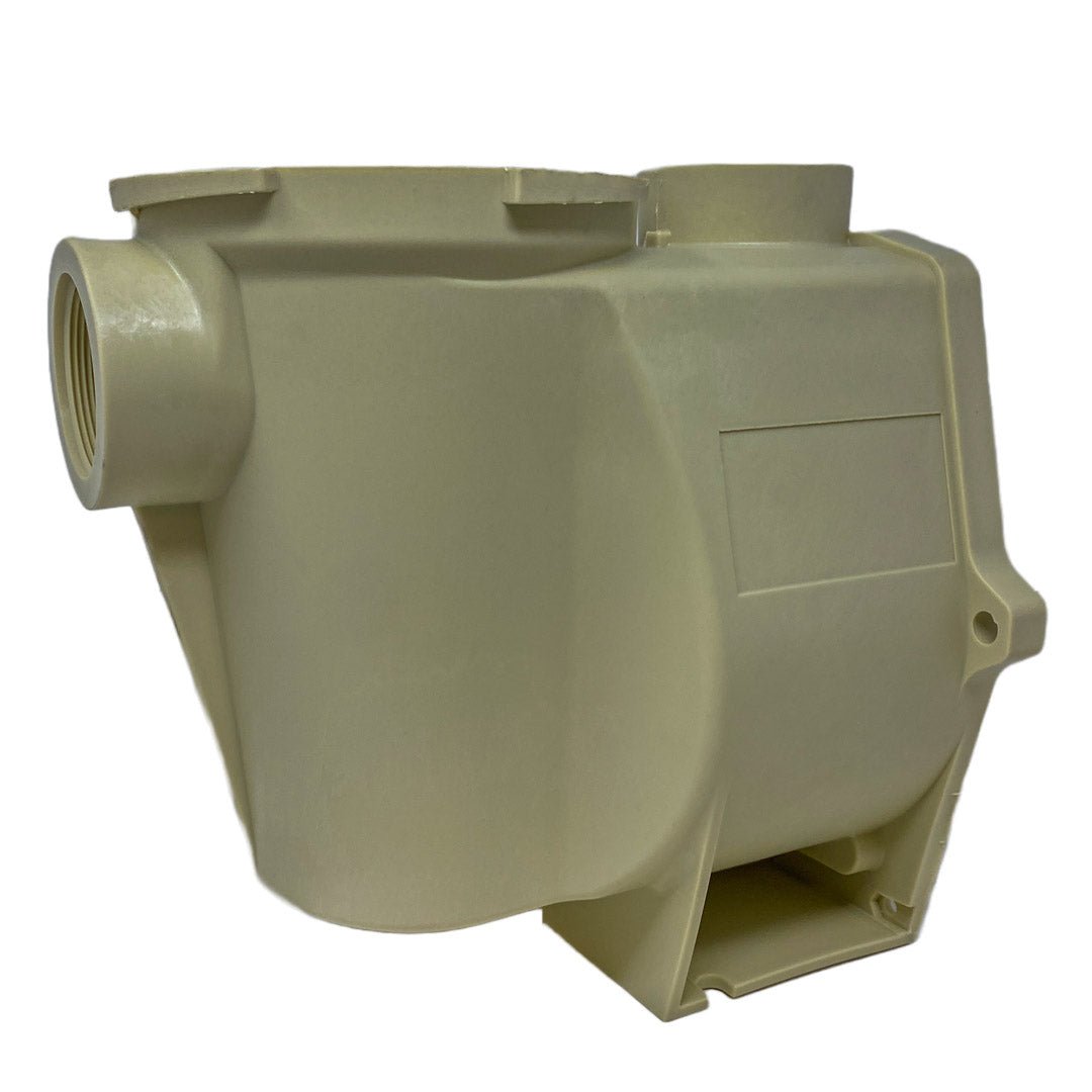

You have a very sharp eye. Ugh!!!. Maybe a worm clamp on the outside also to keep it from going further. I couldn't feel the crack with my fingers but it seems like it is there from the picture. Would hate to lose the pump (obviously)
Sorry my vocabulary is getting even worse as I am focused on that "crack" (are you a dentist?) When you say strong sealant for the union to the cracked part of pump are we talking about pvc glue?
Sorry what do you mean "front" and "discharge" in this case? Do you mean a union on the pump and on the pvc that goes to filter?A sweep union on the front and a sweep union on the discharge with a sweep 90 to make the horizontal to downward turn.
If the pump moves forward some, the discharge does not need to be perpendicular to the pump; it can be at an oblique angle (either acute or obtuse).
Note: Make sure to get pressure rated sweep 90s and not DWV.
You can use a regular 90 instead of a sweep 90 if that is easier to find.
