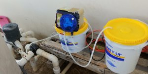

So I have 4 Rolachems 2 Stenners and some Hayward controllers. I have a source for 15 gallon containers of LC. I would like to make a LC feeder with the equipment I have. I don't think it would be that big a deal. Replace the tubing in a peristaltic pump and connect it to the container and to the plumbing after the heater (edit) with a check valve. Control the pump with a timer (edit) timer is built in, and bobs your uncle right? I would need to know the best tube to use, and where to pump the LC from, (top or bottom) the holes are already in the pipe from the heater. What am I missing?
