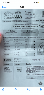

@PoolStored @ajw22 this morning's results. We will add two more gallons of acid and one gallon of the splashes bleach per your request and test again in the afternoon.
