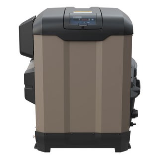

Look at gas heaters with condensate management. They capture the corrosive condensate and drain it off instead of dripping in the heater. If you get one wrap the condensate drain tube with heat tape so it does not freeze in the winter.
Look at the Pentair ETI 400 or the Hayward HC Series.
