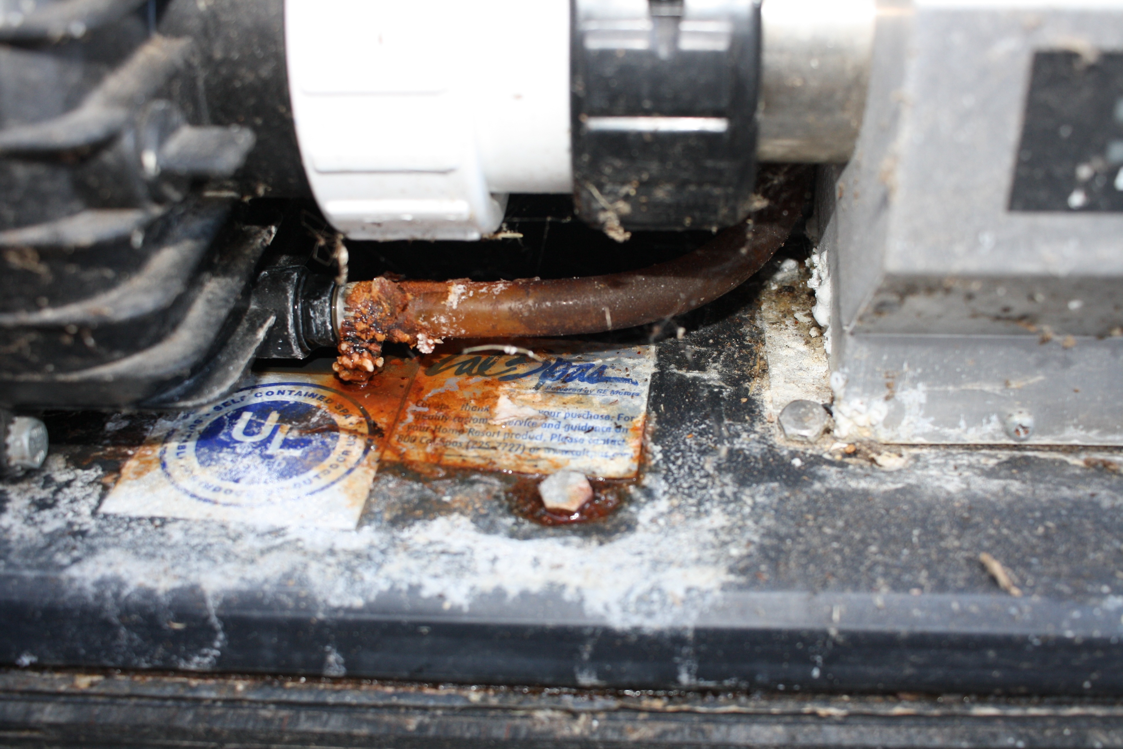

Weather was warm today, currently 46 °F and sunny! Snow is melting at a good clip, but we have another 7-11 inches of snow coming in, starting Monday night, so today was just a teaser for spring. That said, I did finally get around to pulling off the access panel on the spa and taking a look.
Hmm, what's that rusty wet spot under the pump on the left?
I turned both pumps on high, and took a closer look. At the top of the drain fitting water was spitting out. Not a ton of water, but it's a leak nonetheless. It seems to go away when the pumps are off, but I think it leaks even with the pump on low. This is the pump that runs high for jets, low for circulation when needed and when heat is called for, so it has a lot of low speed run time even when we aren't using the spa. You can see the water spitting out in the picture, frozen by the flash. Good news is that looks to be an easy fix in that location. Not only is it out front, but if functional, both pumps have gate valves on the inlet and outlet, so I don't even have to drain the entire spa to fix that leak.

Drain hose. This should be connected to the low point in the spa, and is also connected to the drain points on the motors. You know, the point I have a known leak.
In summary, I have one known leak. Based on what I can see, the other three sides of the spa appear to be stuffed with spray foam, and so if I have a leak anywhere else, I'm probably not going to be able to find it. I suspect it will be a while before I get around to fixing that leak. At the minimum I have to wait for the snow to pass and the return of warmer temps. And since that pump is needed for heat and circulation, I need to get everything lined up for a quick replacement so I don't take our spa down for a long time.
