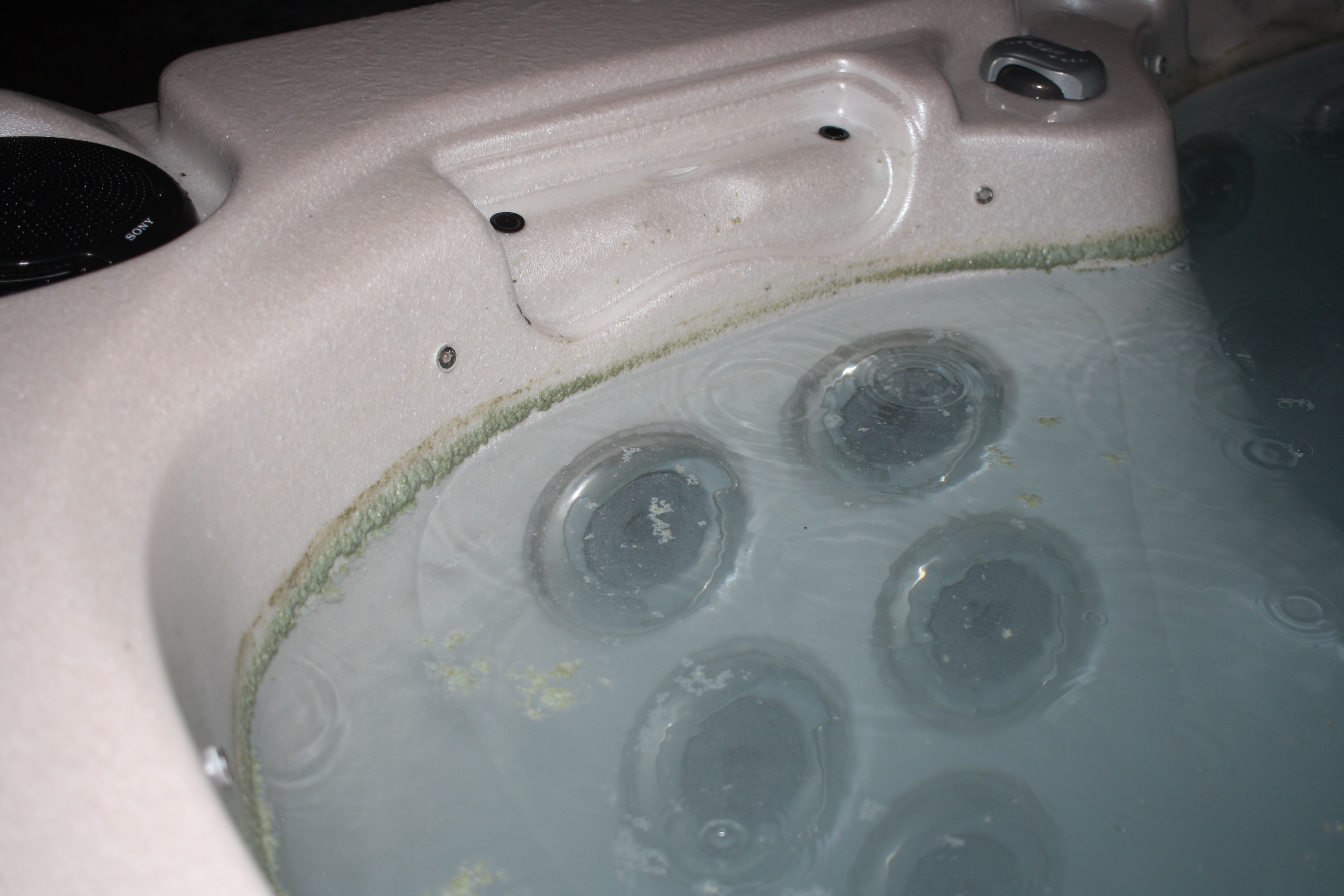

I’m not certain if we ran another 15 minutes of jets when we got back or not. In either case, after ~25 or ~40 minutes of jets, this was the result. The water had cleared up (which was a surprise), and there was a nasty,
nasty ring of greenish-black junk around the entire edge of the spa at the waterline.
We wiped it off with paper towels as best as we could, as that was all we had. It was very sticky. We should have worn gloves (as the Ahh-Some says to do). We washed our hands extremely well after this!

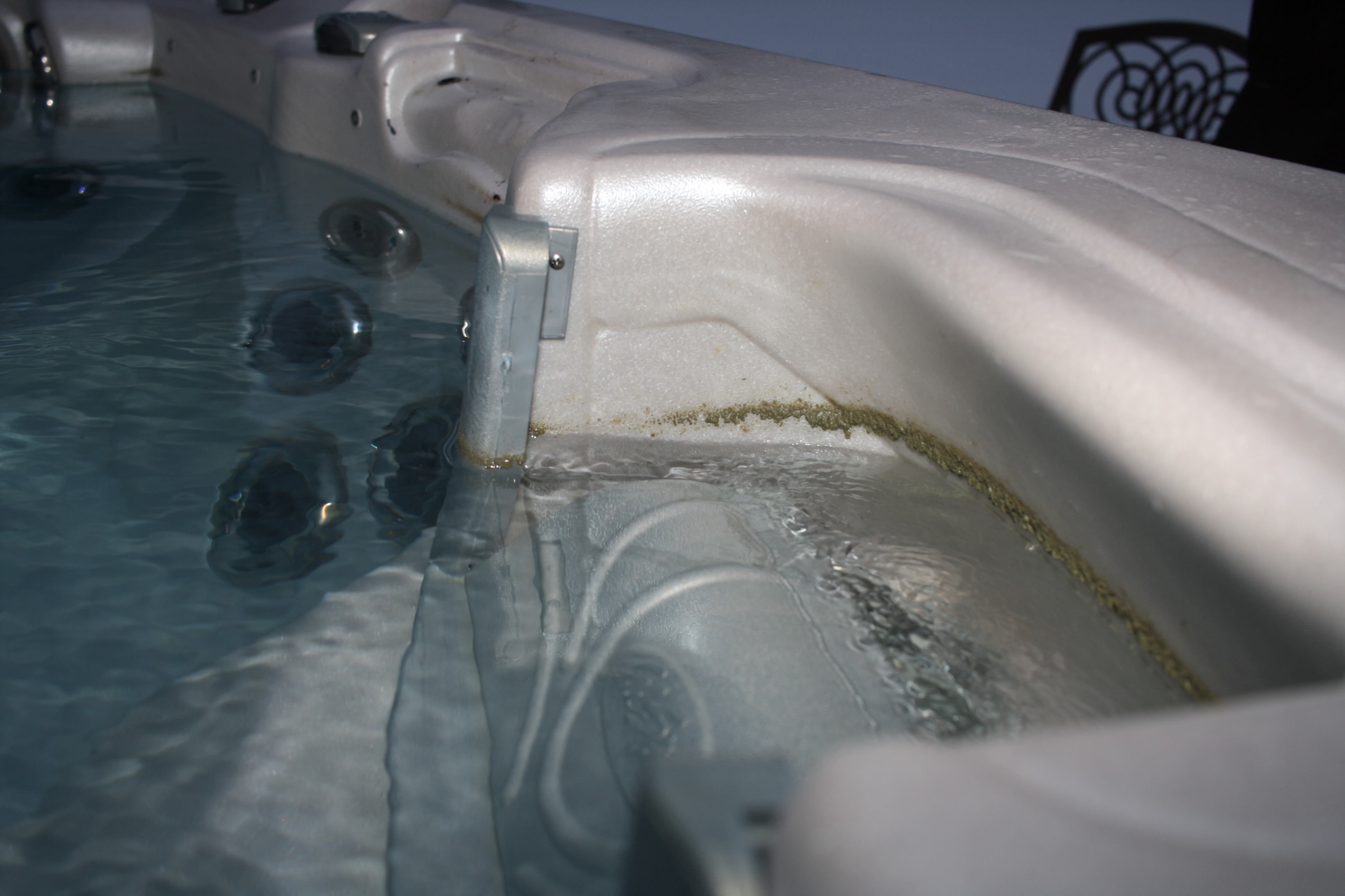

Without draining, I added more Ahh-Some and started the jets for round #2. As with before, more stuff started coming out almost immediately, though it was less than before, and less black and more green.
This shot shows the color difference really well. I think I forgot to wipe off inside the skimmer the first round.
All the blacker bits were leftovers from the first wipe. Paper towels are pretty weak to be wiping this off, it’s really sticky stuff!

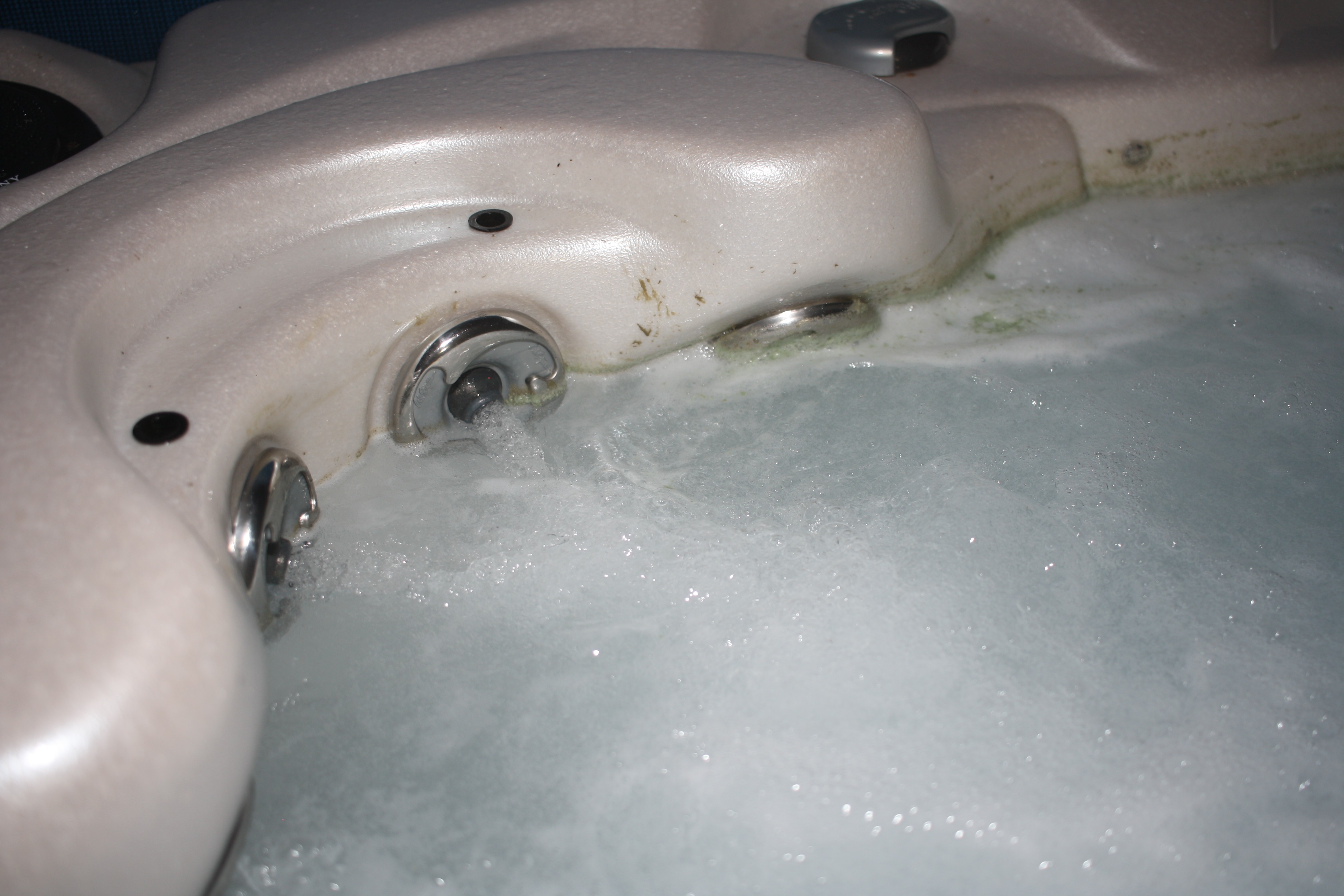

After running the jets for the recommended minimum of 30 minutes, we ended up with a bunch of greenish junk on the edges and floating around in the water.
The “ad shot”, as I thought of it. Really, really gross stuff, but the Ahh-Some
undoubtedly works! People soak in spas with this junk in their pipes!

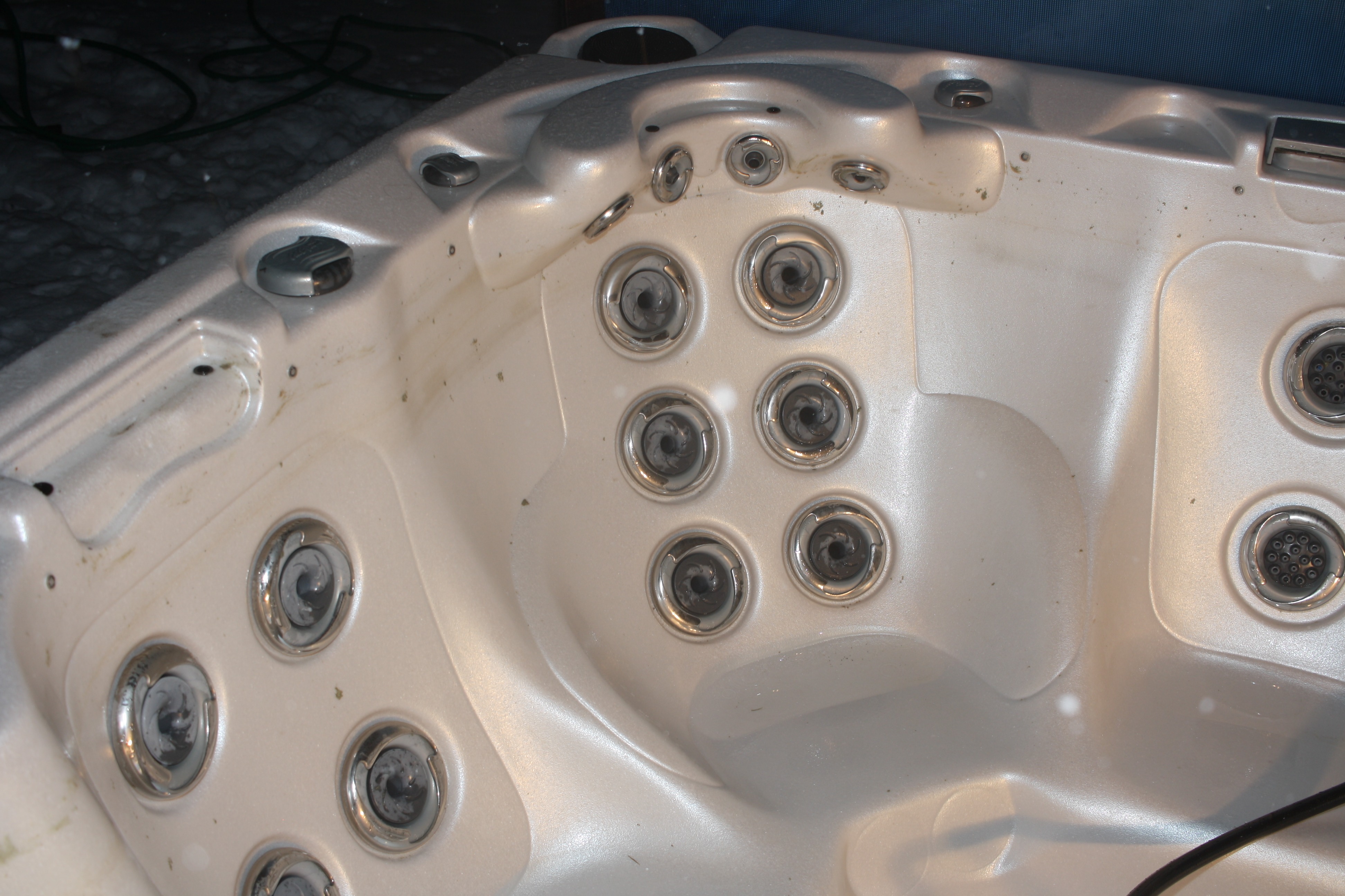

You can see flecks of junk around the edges of the spa, both at the waterline and down the seats as the floating junk started sticking to the walls as the water dropped.
I wiped all the seat water into the bottom, sprayed the walls with ~1/4 teaspoon Ahh-Some in a spray bottle, and wiped them off with the heavy duty washable cotton rags we have (and some gloves).

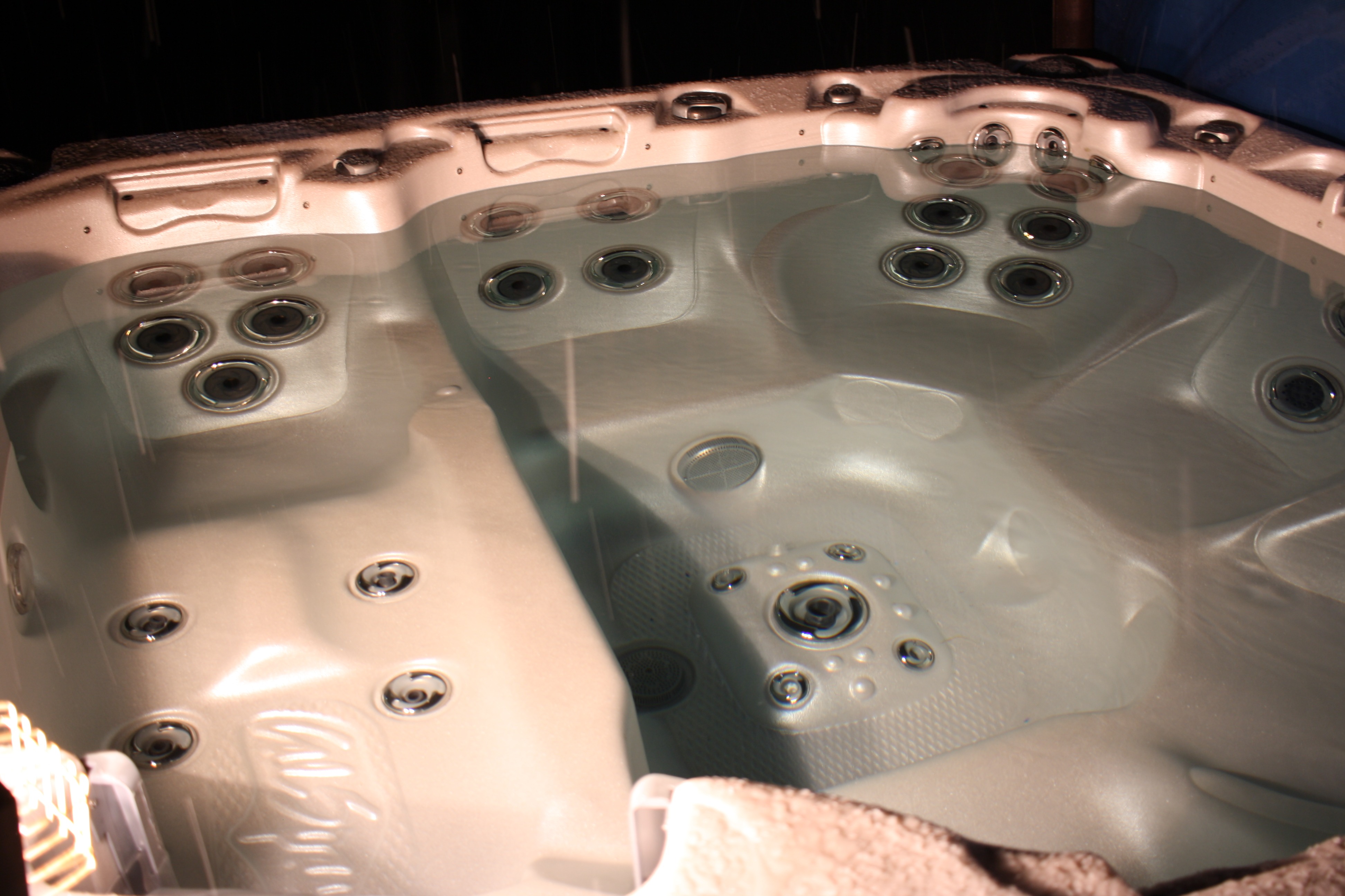

Entire tub after cleaning.
I rinsed down the walls with a hose with running water, while at the same time sucking out water with the pump to pull out as much of the debris in the water at the bottom of the spa as possible. Then, using the manual as a guide, I “opened” all the jets...BIG MISTAKE. I ended up closing all of them, because the manual got the turn direction for open/closed wrong.

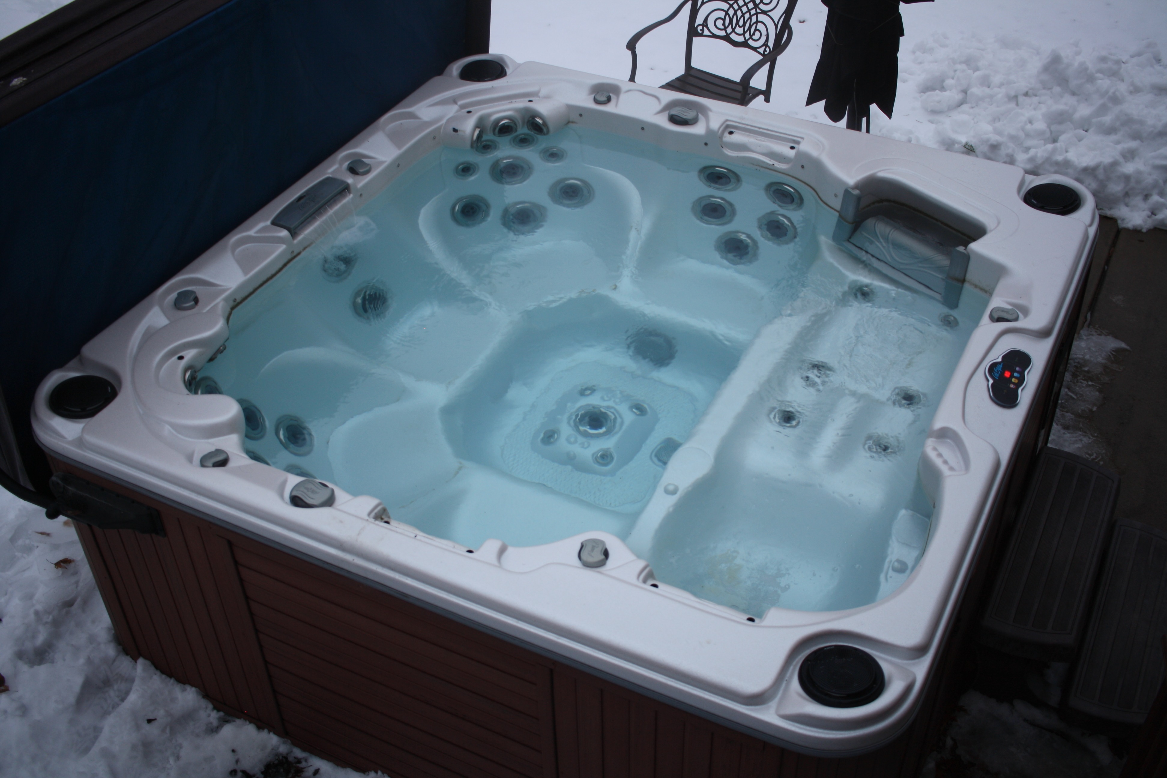

All filled up. Doesn’t that look so inviting now!?
So now that I listen to the manual, I had to go reaching my arm up past my elbow into 46 °F water to re-open all the jets I closed trying to make sure they were all open! That was NOT FUN! With all the jets open (except maybe some of the 5 floor jets, cause I can’t reach those without entering the spa), I left the spa to heat overnight.
Oh yeah, and I added 0.5 oz of dichlor, which should give 5 ppm FC, just so the new water wasn’t sitting without any sanitizer until I get back to it this evening or on Sunday to start purge #3!.
