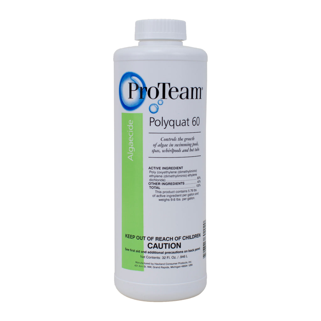

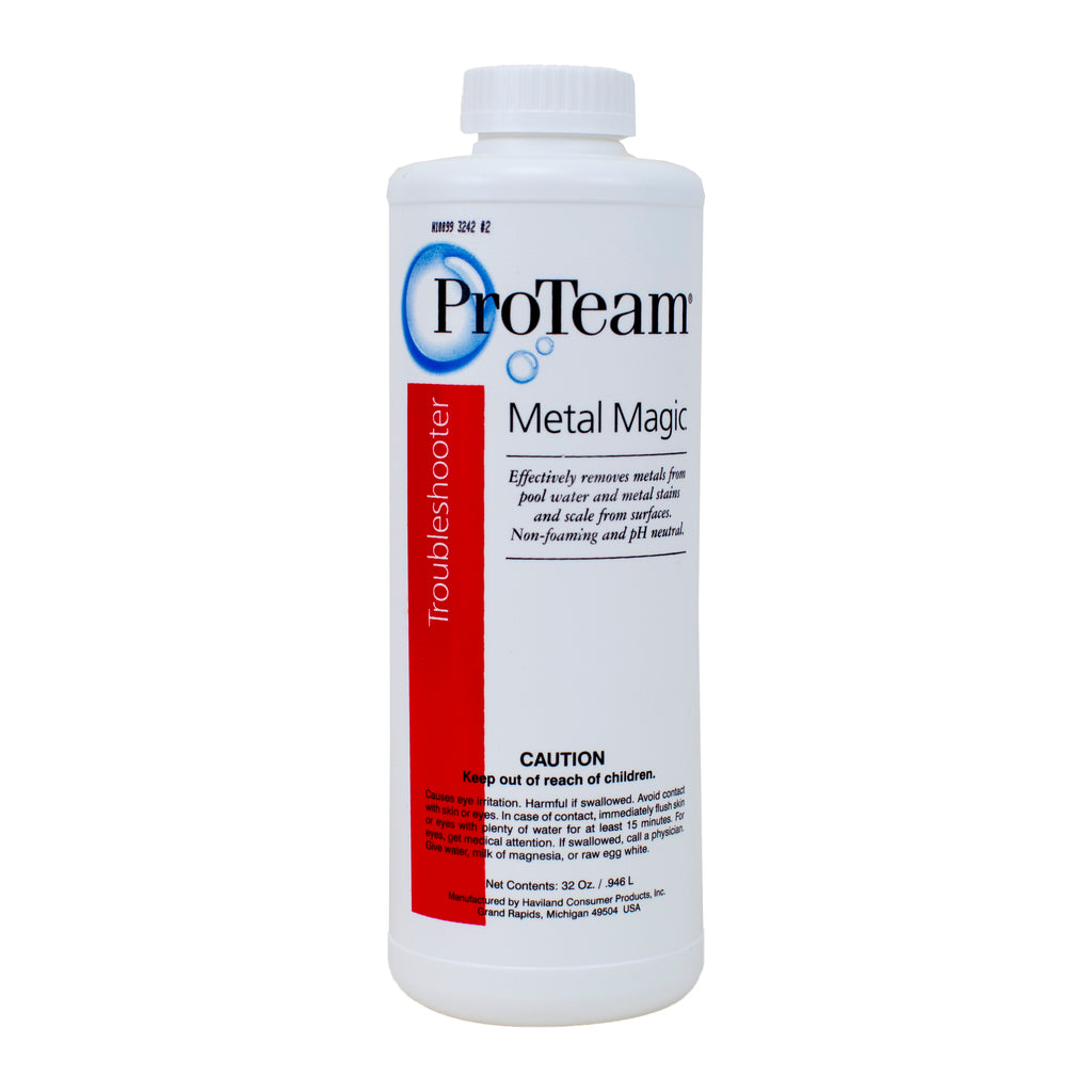

I bought the sequesterant and poly 60 from Pool Geek
I ended up using 5lbs of acid for my 25,000... my entire liner besides a patch in the deep end was stained. However, I think I could have used less. I followed the instructions here
Which say to keep adding until the stains are gone. But, I had a big patch in the middle and all of the side walls were still orange. I added about 2lbs, waited an hour, added another lb, waited an hour, then added the rest, and the directions there say to keep adding it until the stains disappear. In my case the acid needed to circulate overnight. I think if I had used 3lbs, and waited 24 hours, it would have been enough.
So.. to recap
-Let FC drop to about 1
-Added 2 bottles of poly 60
-1hr later, put filter on recirculate and walked around with a cup dusting the acid as well as tossing it out in the middle
-repeated steps as explained above, but the stains never fully lifted until the next morning. i put the filter back to filter and went to bed with stains all over the side walls
-woke up to stain gone, added 3 bottles of metal magic
-24 hours later, i started raising fc. i went through about 6 gallons to eat through the acid.
-I never added more bleach then called for to reach 3ppm, which was the lowest # for my cya at the time, so I was adding cups at a time retesting every 15-30min-then 1-3hrs
-24 hours later, i brought the ph to 7.2

I am going to be attempting to treat my stains again before they're really bad. I believe that I at least located the course of iron in the pool. We discovered the ladder is full of rust.. so it's just been leeching in who knows how long they used it that way. It was out when we got the house, but I bet it was sitting in there until the realtors had the cover made. I had put it back in for about a week. UGH! I tried metal magic last time but I am going to try Jacks this time.
