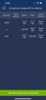

The way this works is that your system comes with three Aux relays.. Aux 1, 2 and 3
You Name the Aux relays anything you want to help you remember what they do..
Someone has named one of the Aux relays as "Lights" and another as "Blower" and I suspect the Aux 3 is not used or at least not named.
It sounds like Aux 1 turns on the blower and Aux 2 turns on the lights.. Is that correct.??
Each Circuit has three attributes.. Circuit, then Circuit Name, then Circuit Function..
For your lights.. The Circuit is "Aux 2", the Circuit Name is "Lights" and the Circuit Function should be "IntelliBrite"
Check and see of the Circuit function for "lights" is IntelliBrite.
Menu, Settings, Circuit Function.. Scroll down and find "lights" and see what the function is.. I doubt it matters, but worth checking..
Sometimes the EasyTouch can store schedules that do not show up in ScreenLogic.. just to make sure, use the main panel and check to see that only the schedules you want are actually in the EasyTouch..
Menu, Schedules, the Scroll through and see what is in the EasyTouch.
Sorry, but I do not understand why your lights do not work when scheduled..
