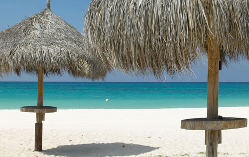

Anyone have any experience with building an island style Palapa?
We are frequent Aruba visitors and love sitting under these. Would like to build as part of our new pool landscape. I have seen kits, but would like to build from scratch except thatch.
Anyone have any info?
