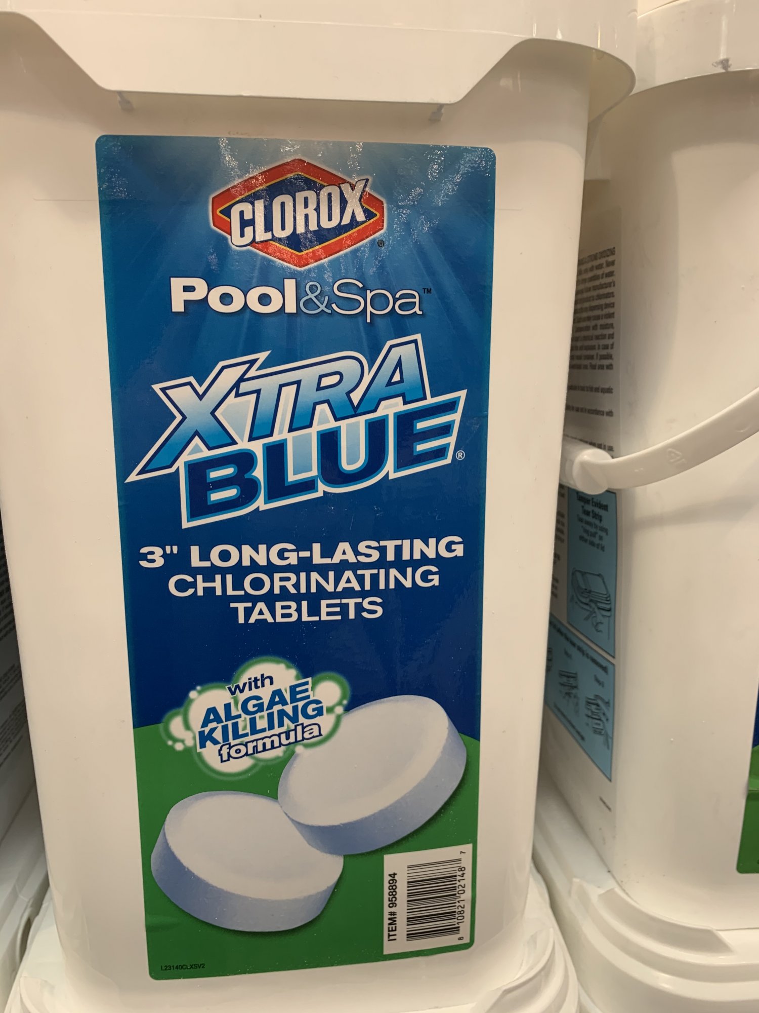

Have you used any Clorox Blue Tablets like sold at Costco?
Exactly what I’m using.

Those contain copper. The "Blue" is a code word for copper addition.
You have copper staining.
