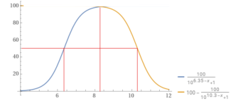

The pKa determines the percentage vs. the pH.
When the pH = pKa, then that is where the molar percentage is 50% for each.
For carbon dioxide, the pKa is about 6.35.
For bicarbonate, the pKa is about 10.3.
So, the percentage bicarbonate is 50% or higher for the pH range of about 6.35 to 10.3 and 8.3 is about in the center where the percentage is close to 100% but slightly less than 100%.
_____________________________________________________________________________________
Percentage bicarbonate.
You can use the formulas to calculate the percentage of bicarbonate vs. carbon dioxide or vs. carbonate.
100÷(1+10^(6.35 – 8.3)) = 98.8904% bicarbonate vs. carbon dioxide.
100-(100÷(1+10^(10.3 – 8.3))) = 99.0099% bicarbonate vs. carbonate.
So, at a pH of 8.3, you have have a mix of carbon dioxide, bicarbonate and carbonate.
You would have about 1% CO2, 98% bicarbonate and 1% carbonate.
You would have about 1.09873% CO2, 97.922% bicarbonate and 0.979221% carbonate.
