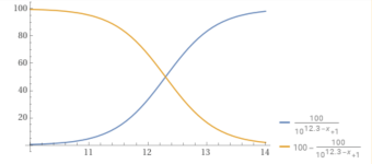

Calcium phosphate is Formula: Ca3(PO4)2.
At 25°C and pH 7.00, Ksp for calcium phosphate is 2.07 × 10−33
phosphoric acid (H3PO4) has 3 pKa values. 2.1, 7.2 and 12.3.
So, even though phosphoric acid has a high pKa for the phosphate ion, the Ksp of calcium phosphate is very low and the risk of calcium phosphate scale is high with very low levels of phosphate.
You need to calculate the actual carbonate concentration by subtracting the contributions of things like phosphate, cyanurate and borate to the total alkalinity.
