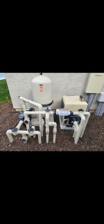

The top of the pool doesn't seem to skim at all. I dropped a leaf in front of the skimmer box and it just moved past. The suction is very very low.Why do you want to increase the pump speed?
I don’t think the Inital Setup to the app was done for your pump.I think it may be pulsing.
The way you do that is you create a feature circuit named PUMP 2400. Set it to display on Home Screen.The top of the pool doesn't seem to skim at all. I dropped a leaf in front of the skimmer box and it just moved past. The suction is very very low.
Thank you!! This worked!I don’t think the Inital Setup to the app was done for your pump.
Read the Pump app manual I linked to.
Page 2 tells you to setup an account which I think you already have for the IntelliCenter.
Put the IntelliCenter in SERVICE mode to release the pump control.
Then follow page 3 Pairing the pump to your app.
Or you can tell your builder setup guy to get it done.
Ok. So what else do we need to work on?Thank you!! This worked!
Now CONNECT and ON/STOP are green. The QUICK CLEAN is not lit up.Ok. So what else do we need to work on?
What color is that yellow LED now with the IntelliCenter in AUTO?
Thank you. I am reading and trying to understand this.The way you do that is you create a feature circuit named PUMP 2400. Set it to display on Home Screen.
Then you go to the pump settings and set 2400 RPM to the PUMP 2400 circuit.
Now you will have a button on the IntelliCenter and when you turn it on the pump will run at 2400 rpm. You can also schedule a skimming time or a few hours every day when that circuit will run and skim the pool.
You probably don’t need max RPM for good skimming. Try 2400. It works on my pool. Then adjust it to find what works on your pool.
You can create multiple Feature Circuits for different speeds you want to run your pool.
Is your heater circuit set to a RPM that gives at least 50 GPM? Minimum flow for your MasterTemp is 40 GPM. Running the heater with too low flow can damage the heater.
I think CONNECT should be magenta/pink when the IntelliCenter is controlling the pump.Now CONNECT and ON/STOP are green. The QUICK CLEAN is not lit up.
How can I test this on the app?I think CONNECT should be magenta/pink when the IntelliCenter is controlling the pump.
Keep that in mind if the pump is not responding to the IntelliCenter. I think you may have other setup issues.
How would I test this to see if the automation is working? Can I do a test setting on the app somewhere?I think CONNECT should be magenta/pink when the IntelliCenter is controlling the pump.
