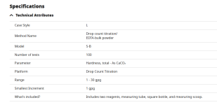

Hach5b only reflects hardness as CaCo3
625 on the Taylor , 890 on the 5b)
1 GPG = 17.118 ppm.
30 GPG = 514 ppm.
Looks like you are outside the range of the test.
The 5 B test Total Hardness, which includes Calcium and Magnesium.
Total hardness is the sum of calcium hardness and magnesium hardness, while calcium hardness is the amount of calcium in water.
The Role of Calcium Hardness in Water Balance
While hardness in water consists of both calcium and magnesium salts ("total hardness"), only the calcium component is relevant in the water balance calculation for pools and spas.
Called the Saturation Index (SI) formula, it considers the interrelationships of four chemical factors—calcium hardness; pH; total alkalinity, as corrected for the contribution of any cyanuric acid stabilizer in use; and, to a much lesser extent, the total dissolved solids level—plus one physical factor, water temperature.
Another common measurement of water hardness is known as total hardness as CaCO3.
This measurement takes into account both Ca2+ and Mg2+ ions.
On average, magnesium hardness represents about 1/3 of total hardness and calcium hardness about 2/3.
If you are comparing your own test results of calcium hardness as CaCO3 with results in publications that use units of total hardness as CaCO3, you can estimate total hardness by multiplying the calcium hardness by 1.5.

Thank you that makes sense so while I was outside of range, assuming a larger margin of error the hach and taylor somewhat agree with each other.
I had bought the hach to test supply water hardness prior to purchasing a replacement whole house softener (which unfortunately does not go to the pool autofill) so it was a "why not" try it on the pool.
