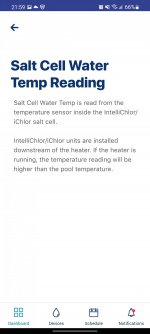

I am an iPhone user, so I am curious... What happens when you click on the 'about the temp reading' text in your app? I don't have that and my chemistry tab doesn't show any temperature. The only temp my intellicenter app shows is the air and water temp probe readings.
--Jeff
Basically to keep in mind that it's downstream from the heater.
