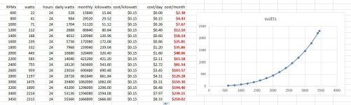

They do get bigger when the RPMs are up more. We like them and the relaxing sound they give. Grand baby like them too.FYI: You only really need to have the RPMs high enough to satisfy your SWG's flow switch when you aren't in the pool. For yours that is as little as 1000 RPMs. You can experiment to find out. Those 2 little water sprinklers aren't doing anything at all to cool your pool off btw.
See this chart how much it costs to run your pump.
